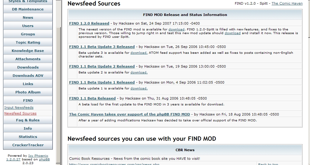

Post Re: Forum Integrated News Delivery
Newsfeed Sources yes you have fixed that problem see screen dump! enclosed!
but i do have one problem still if you got any ideas how i can fix this ! cos i am out ideas!
all seemed to go to plan until I tried to add a feed.
The Forum Name drop down is blank! (see pic)
wait a minute, how did you make Newsfeed Source works.  I can't get the page.
xmenfile down load and install admin_newsfeed_sources.rar here!
Zuker has fixed it! but i am still having problems with the news feed adding forum!
darkasylumSend private message
darkasylum, for me it's working fine.. check this image

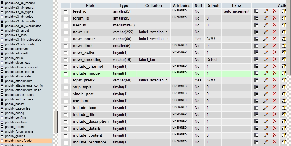

Zuker  yes Chaotic  has working two!
this only problem i had from day one! No drop down menu so cant add a Forum!
i think it sumthing to do with Mysql data base! i enclose screen dump
just incase you see sumthing i missed, thanks Zuker
Filename: MYSQL.jpg
Filesize: 369.71 KB
Downloaded: 172 Time(s)
