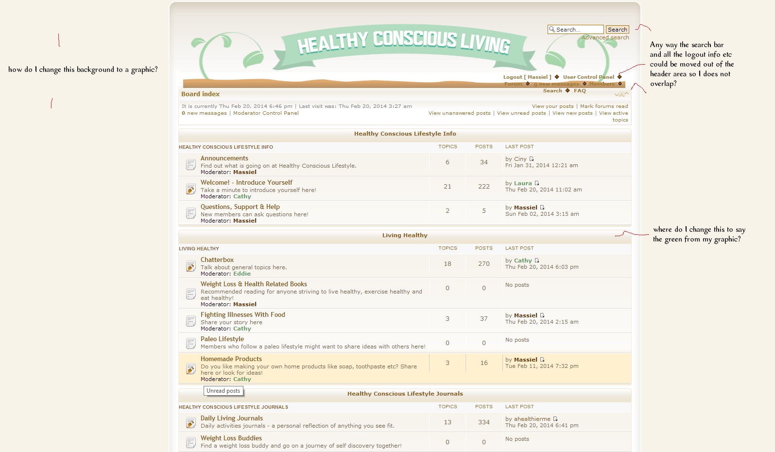

So, I need to modify the looks of the style so it fits with my site's main page a little more, or blend better.
This is my main site www.healthyconsciouslifestyle.com - these are the forums - www.healthyconsciouslifestyle.com/forums
I want to be able to change the background color, fix the header area and change the color of the forum headers, see my problem is I am very new at this, I can follow instructions but I don't know where things are like most of the people at phpbb forums do.  I've looked around in some of the files but I don't want to mess things up so I'm here to ask you instead.
This graphic kinda explains what I need.
Filesize: 275.52 KB
Viewed: 156 Time(s)

Massiel wrote: [View Post]
I would probably be able to figure out how to change the background to a graphic if I knew which file to edit and which line to change.  Your link doesn't really tell me those things
Yes it does - It's in the *.css file under the body tag?
So all you need to do is add an image URL to the body tag as depicted in the wc3 example.
There should be plenty of examples in the .css as to how current image paths are added to the current theme.
As for removing the search block in the header (Although I thought that it could be turned off in the ACP?)
Find this code in overall_header.html and remove it.
        <!-- IF S_DISPLAY_SEARCH and not S_IN_SEARCH -->
            <div id="search-box">
                <form action="{U_SEARCH}" method="get" id="search">
                <fieldset>
                    <input name="keywords" id="keywords" type="text" maxlength="128" title="{L_SEARCH_KEYWORDS}" class="inputbox search" value="<!-- IF SEARCH_WORDS-->{SEARCH_WORDS}<!-- ELSE -->{L_SEARCH_MINI}<!-- ENDIF -->" onclick="if(this.value=='{LA_SEARCH_MINI}')this.value='';" onblur="if(this.value=='')this.value='{LA_SEARCH_MINI}';" />
                    <input class="button2" value="{L_SEARCH}" type="submit" /><br />
                    <a href="{U_SEARCH}" title="{L_SEARCH_ADV_EXPLAIN}">{L_SEARCH_ADV}</a> {S_SEARCH_HIDDEN_FIELDS}
                </fieldset>
                </form>
        <!-- ENDIF -->

html, body {
   color: #536482;
   background-color: #000000;
   background-image:url("{T_THEME_PATH}/images/hclbg.jpg");
   background-repeat:repeat-y;
so why is it only changing the left side?
Another problem I am finding is that after I edit the colors.css file, the New Post, New Reply buttons disappear and I only have a text line option, I am not sure why that's  happening
MassielSend private message
Post Re: I'd Appreciate Your Help With A Few Things...
This line tells the image to ONLY repeat in the vertical position.
Just remove the whole line.
I guess there are some things left to answer...
For "the green from my graphic"
Take a look at this
.tbl-h-l
  background-color: transparent;
  background-image: url("styles/frozen_phoenix/theme/images/blocks/tbl_h_l.gif");
  background-repeat: no-repeat;
  background-attachment: scroll;
  background-position: left bottom;
  background-clip: border-box;
  background-origin: padding-box;
  background-size: auto auto;
  padding-left: 27px;
You have to change this button tbl_h_l.gif and also tbl_h_r.gif.
You can do it by your own or you can create the colors you want with this tool.
http://www.icyphoenix.com/styles/co...=frozen_phoenix
Play with it and download it after that. Use the graphics you would like to use.
