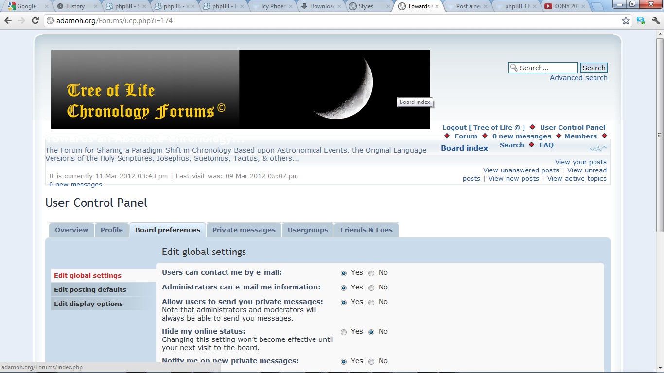

I am not quite sure how to word this question other than by attaching a PrntScrn for your review...
Please notice how my logo at the top is covering the area of the form below it, and also how the title of the subtitle below is barely visible, that is, the words "Towards an Absolute Chronology..."
What can I do to solve these problems such that I may use the Frozen Phoenix Style for phpBB3?

I guess you would have to adjust the height of the logo area in common.css called header-box (or use an image that fits the area)
Then you would need to replace the searchbox to a new location in overall_header.html (removing it from the page_header div block)
That would be this piece of code:
        <!-- IF S_DISPLAY_SEARCH and not S_IN_SEARCH -->
            <div id="search-box">
                <form action="{U_SEARCH}" method="get" id="search">
                <fieldset>
                    <input name="keywords" id="keywords" type="text" maxlength="128" title="{L_SEARCH_KEYWORDS}" class="inputbox search" value="<!-- IF SEARCH_WORDS-->{SEARCH_WORDS}<!-- ELSE -->{L_SEARCH_MINI}<!-- ENDIF -->" onclick="if(this.value=='{LA_SEARCH_MINI}')this.value='';" onblur="if(this.value=='')this.value='{LA_SEARCH_MINI}';" />
                    <input class="button2" value="{L_SEARCH}" type="submit" /><br />
                    <a href="{U_SEARCH}" class="" title="{L_SEARCH_ADV_EXPLAIN}">{L_SEARCH_ADV}</a> {S_SEARCH_HIDDEN_FIELDS}
                </fieldset>
                </form>
        <!-- ENDIF -->
Possibly put it below <!-- INCLUDE menu_block.html --> or <!-- INCLUDE breadcrumbs_main.html --> (but it's a matter of taste )
and then you'ld need to check how it starts looking because I wrote this without trying

Thanks for helping me see my own problem! The three proverbial fingers pointing back...
Yes, per your suggestion I adjusted the logo area in... [the imageset.cfg file...] and voila, it worked!

To save you the time and bother of registering into my free paradigm shifting discoveries re a more absolute reckoning of time, I'll attach for you another attachment showing my solution to this problem of mine:

that's a nice fix too
One little thingi ..if you are shrinking the logo anyway, you may want to consider editing it (this would make the actual size of the image smaller, which can only be to your advantage IMHO)
