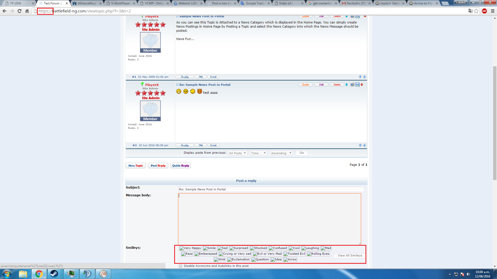

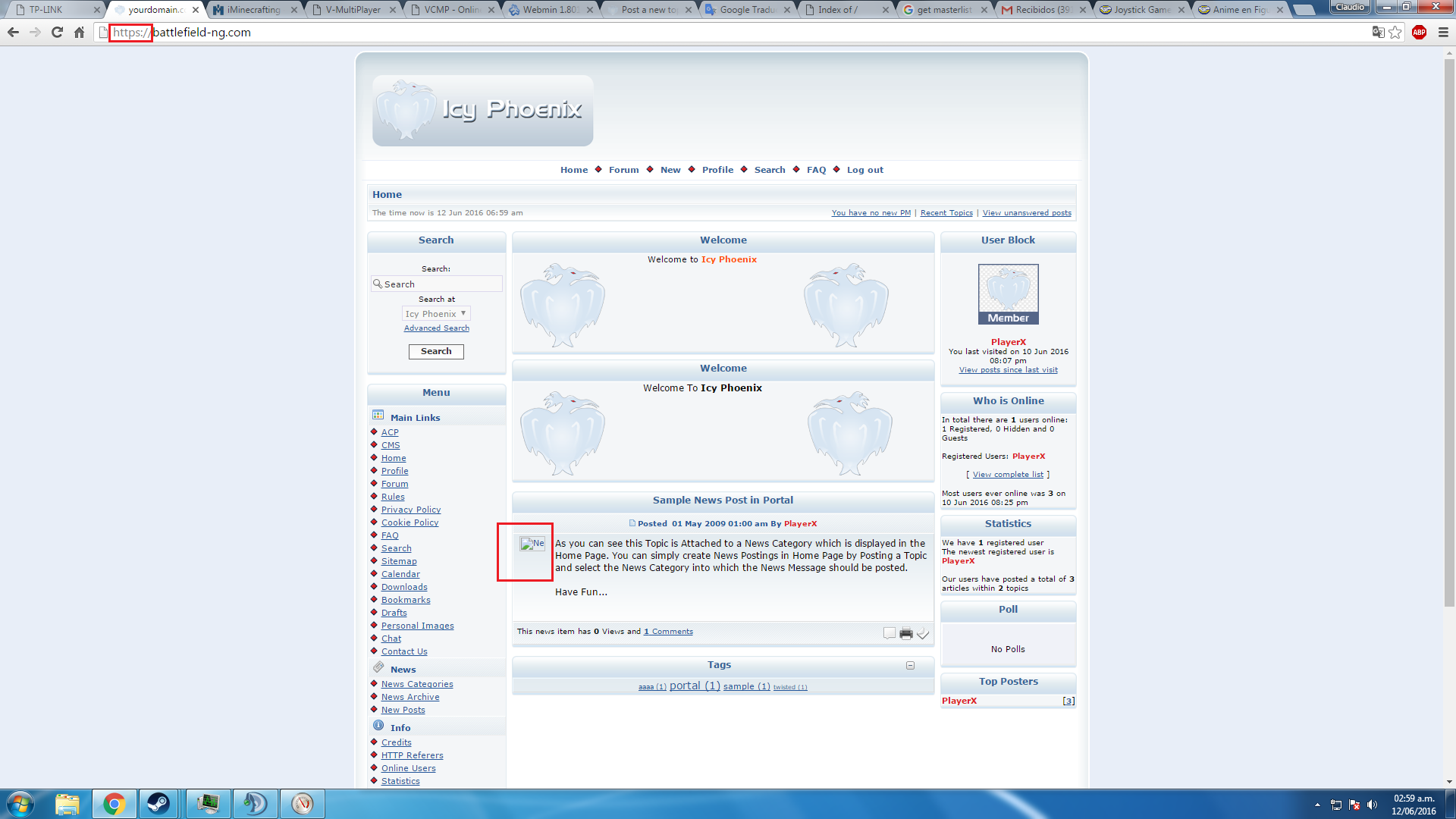

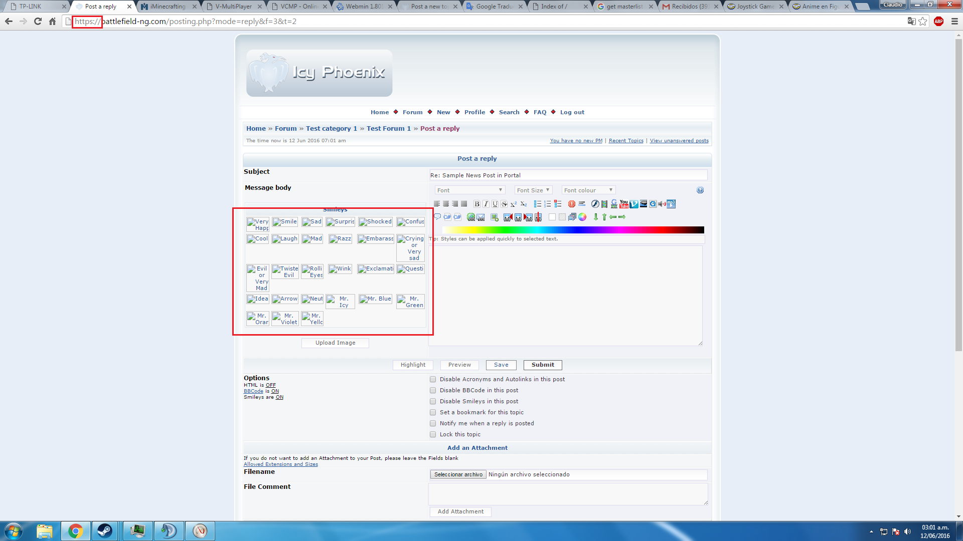

I found several problems viewing images with SSL certificate, attach the photos to see.
If I find more problems with images, I'll put it here.
