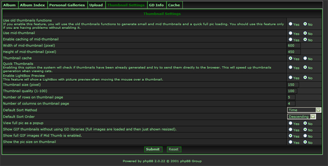

thats what mine looks like as well. I did have troubles with my thumbnails (and worse) when my hosts installed the mod evasive(?) on the server. All it needed was a little tweaking (apparently) and then it worked fine again.
Have your hosts at all yet?
In any case I attach a copy of my ACP Thumbnail settings for your info.
wrt to the code it is in no file. I had that part from another mod I have installed but I am sure you can easily include it in e.g. admin/admin_album_config_upload.php to show you what the maximum filesize is you can upload. For some odd reason this maximum does not apply for nuffload on my board, or at least so it seems.

Filename: ACP-Thumbnail-Settings.jpg
Filesize: 145.81 KB
Downloaded: 1252 Time(s)
