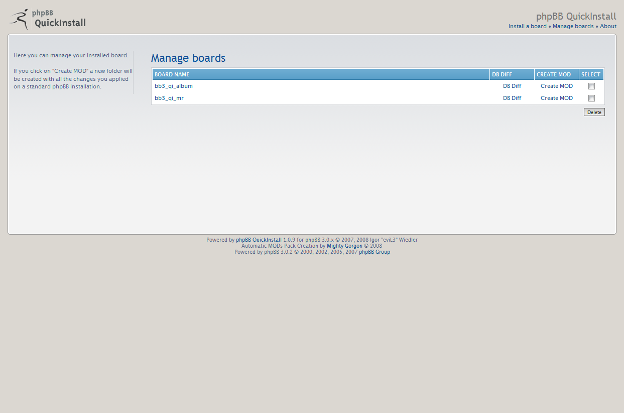

- When you want to create a mod go to "Manage boards" section and you will see two new links:

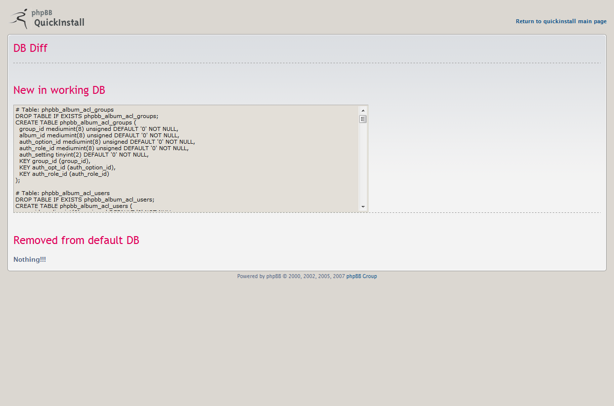

- DB Diff: which outputs to screen the differencies in DB structure (only structure) respect to a clean phpBB 3.0.2 installation.
- Create MOD: which creates a new folder into mods with all the new files and the XML with the modifications to apply to standard phpBB 3.0.2 files.
Some screenshots:
Of course the output won't be perfect... it will still require some manual editing... but this tool will help at least to double check all the changes.
