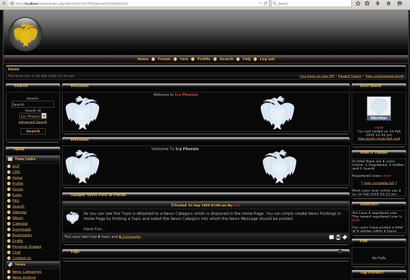

For testing, I setup a test site with no previous db, just a clean install of icy from github and the black pearl theme. I have attached an image below, as you can see all is default
Black Pearl
Filesize: 138.06 KB
Viewed: 251 Time(s)

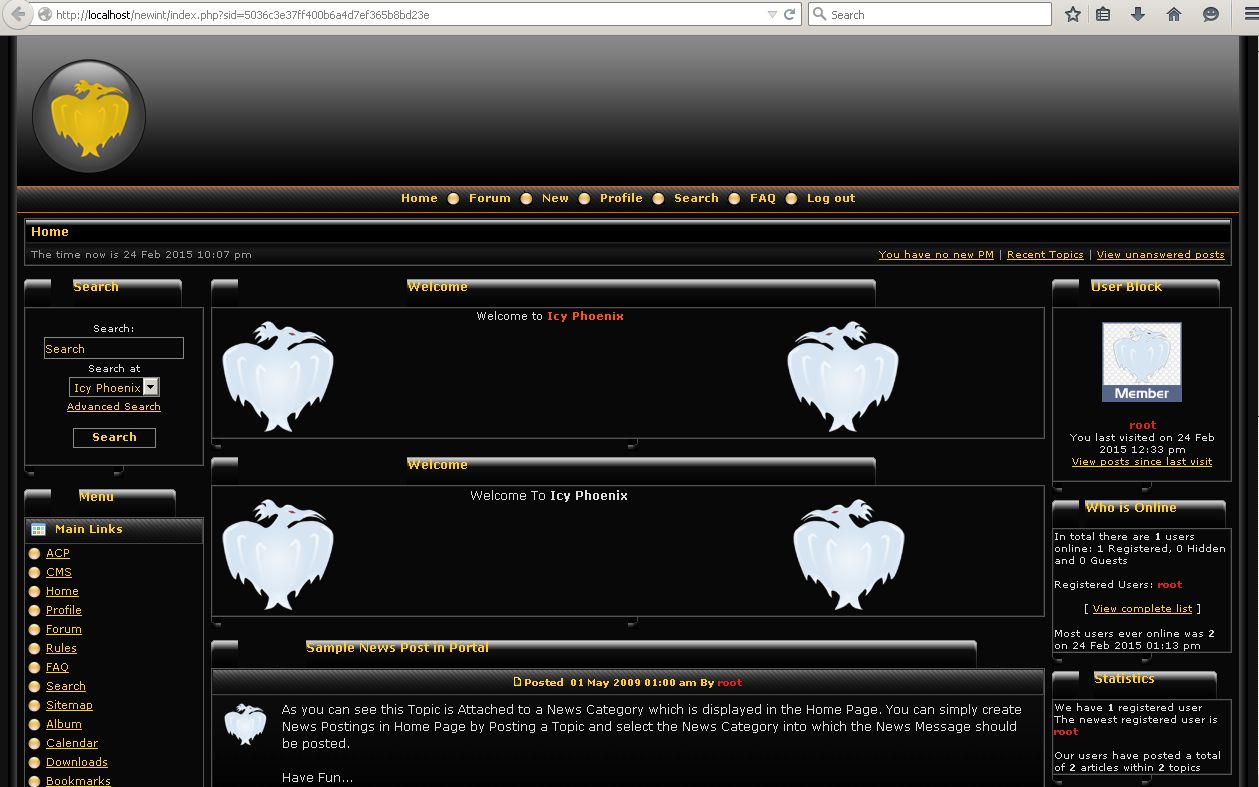

Thanks mort, that did the trick!
And thanks for all the other input, we now have this solved and with a perfect end result!
Filesize: 158.36 KB
Viewed: 226 Time(s)

I noticed another problem with that piece of css. The forum type headers are two different heights.
This should fix it.
.roundedhc {
    background: url('images/p_black/tbl_h_c.gif') bottom left repeat-x;
    width: 100%;
    height: 29px;
.roundedhr {
    background: url('images/p_black/tbl_h_r.gif') no-repeat;
.roundedfl {
    background: url('images/p_black/tbl_f_l.gif') no-repeat;
.roundedfc {
    background: url('images/p_black/tbl_f_c.gif') top left repeat-x;
    width: 100%;
    height: 29px;
