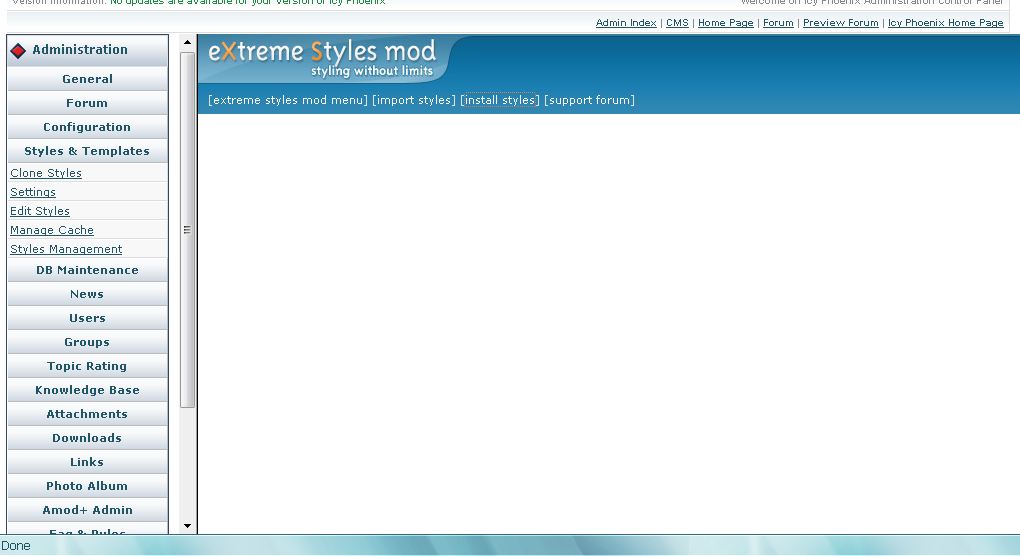

Still not working.  Clicky SS
Maybe that can help you.

Post Re: Could Use Help
did u upload all admin xs files?
and the ones here
templatescommonxs_mod

Yes I have uploaded all of them.

It could be a memory limit issue.
Try to raise your PHP Memory usage.
Press 22 wrote: [View Post]
If it hasn´t got memory, it´ll apper a message. It could be from the *.tpl file related to it. But i don´t know what files are they.

Nope, that errors come from server, not from icy tpls
No... it depends... it may not appear any message...
