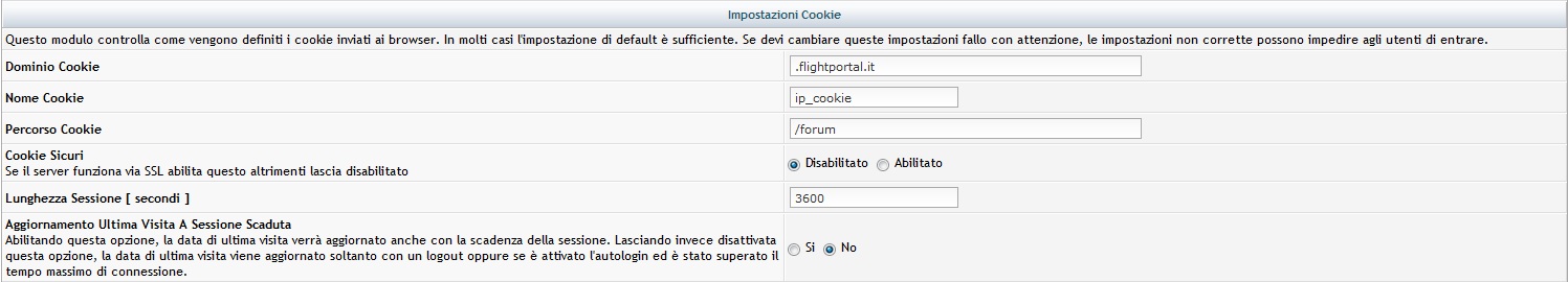

Ok, I apologize for the PM did not want to support via PM. My site is www.flightportal.it, the forum is located in / forum
Ccookie is a typo here on the message.
1. Board location: http://www.example.com/board/
Your settings should be:
Domain Name: http://www.example.com (Note that the domain doesn't include 'http://', which is a protocol)
Script Path: /board/ (Simply the path to the folder with a trailing slash)
Cookie Domain: .example.com (Note the dot in front; the cookie domain always needs to have 2 dots)
Cookie Path: /board (This is the script path without the trailing slash)
Cookie Name: example_cookie (This can be anything (no spaces or periods). Make it original)
Session Length (seconds): 3600 This can be different, but an hour (3600 seconds) is a good number)
Then I think I've figured out the problem, I try and let you know.
Quote: Cookie Path: /board (This is the script path without the trailing slash) correct
cookie path: / currently set
For now, thank you very much, and I apologize for the PM did not know
Edit:
I updated as indicated in the guidelines but still does not work

Since you posted the url in public so now I can freely post your advised settings:
Cookie Domain: .flightportal.it
Cookie name: ip_fp_cookie
Cookie Path: /forum
____________ www.DutchaGoGo.com (development/under construction ...Forever?¿?)

thanks Joshua I updated as you suggested, but the problem occurs again, I deleted the cache of the forum, I deleted the cache and cookies from my browser but the problem persists.
Every time I try to open the ACP from the forum I have this block, Home -> CMS -> ACP is ok
